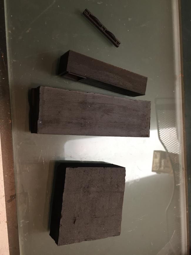

  • OK here's those casting I spray painted black. An important step because I promised myself that I love the look of this kit so much I want to follow the directions explicitly.IMG_2010

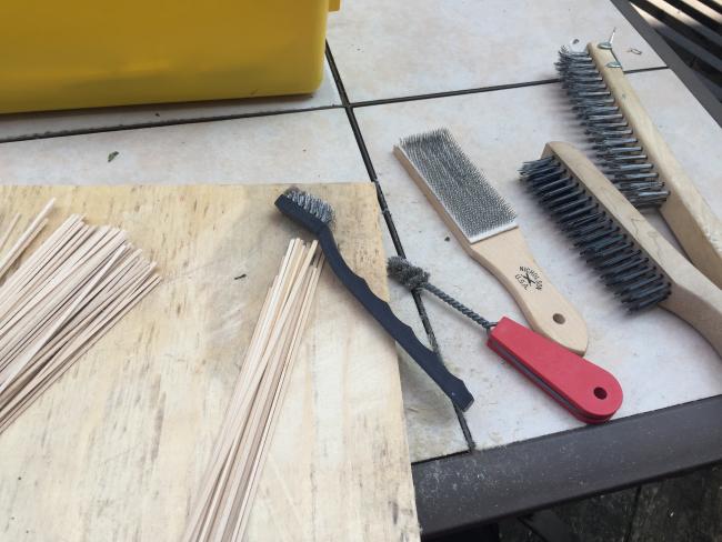

  • Today is wood distressing day. Got all my tools out and a disposable wood surface to scratch away at. You can see the various wire brushes I use. I try not to stick to the same to get variety. I never use a razor saw as the grooves are always too even and pull focus.IMG_2004

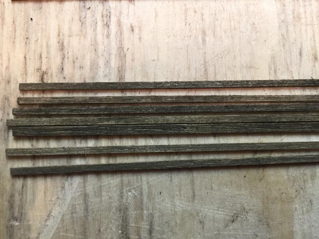

  • Here's a few boards I've added some colour to. Quite pleased. A few were a bit too light so I gave them a quick wash of alcohol and asphaltum (an acrylic aging liquid sold in Lowes this actually set the chalk so they were easier to handle and gave me a nice variety. I wanted the boards a bit dark as contrast to the Ivory paint to come.)IMG_2017

  • That coloration is going to provide an excellent base for the next step!

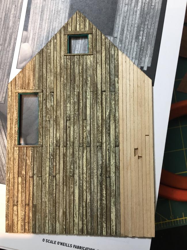

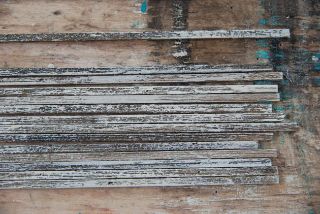

  • Well I tried the "damp brushing" technique and am quite pleased with the results. A few boards were not quite consistent so I strategically brushed them again. Also I found those that I had "fixed" with the acrylic wash the ivory stayed a bit brighter as the chalk didn't affect the ivory paint as much. I went back and re-brushed a few of those and had some nice variation in colour. For the Bluegrass green I damp brushed and then made a second mix of paint with more white in it and dry brushed on top to give a bit more variety and depth. Over all I don't know if I love the effect more than the resist and peel method but I completed all the strip wood in 45mins when I would have completed 10 boards doing the resist. I will now go through the stripwood and pick out the best pieces to use on the front of the building.

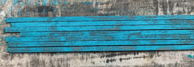

  • I love your ivory boards. They are going to look incredible. My only concern is the trim color. It is designed to be a blue-green but the pic posted is almost an electric blue.

    It does approach electric, but the picture may not be accurate. The ivory are very nice and I am close to saying the same thing on the blue. Boards 1,3,4,5,and 6 don't stand out as much. As trim they would be much shorter and laid against the ivory may be very nice. Joel it your built, your call. I'm digging it either way.
  • Those ivory boards looks great Joel, such a good peel effect you have achieved with this method.
    The blue boards instantly reminded me of my boards on a front wall I built once, and that turned out great. I like the way they are less peeled than the ivory boards and I'm sure the blue isn't as stark in person, plus, once its further weathered and toned down it will look different.
    In regards to your other comment, 99% I model for the camera, mainly because no-one will ever see it in person, only in a close up picture on a screen.

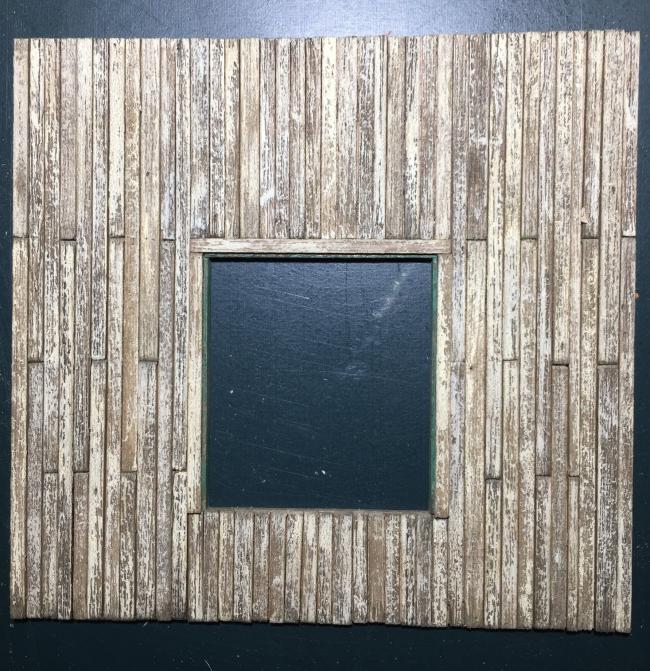

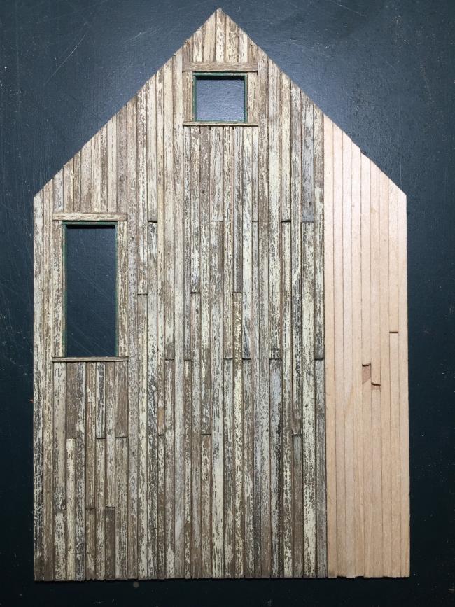

  • Well a good days work (after a long days work). i lined all the windows and doors and completed one wall. I used a tiny needle to make nail holes so most are invisible but you get an impression of them at certain angles. I'll probably hit a few with chalk or rust but I want to see how things come together first. rsz_img_2029
  • I realize the picture looks like the boards on the left are a different colour but that's the lighting ( I told you I was a terrible photographer). The middle area is indicative of the true appearance.
  • edited August 2017
    Looks fantastic Joel.
    Nice tight joints on the window trim and great board selection on the walls.
    Really nice variation in the peel effect but also great tonal differences in the underlying wood colour, came together beautifully.
    Yes, I see what you mean about the lighting, however, the 'yellow' light is also visible on the manual below the illuminated boards, this does not detract from a great wall.

  • Nothing wrong with the photography, crisp, clean and focused on the crisp, clean, dirty modeling.
    Switch out that 'yellow' bulb and any others you work under with 75 or 100W daylight bulbs, you'll be so much happier.... both working under them and with the pictures you take.
    Once again though, that wall is superb.

  • Well I chickened out and redid all the trim in olive green. I tried multiple shades of the "teal"ish blue and tried adding more and more but I really wasn't satisfied. Hope it doesn't throw the balance of colour off too much. rsz_img_2035
