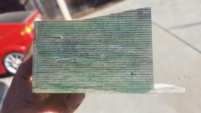

  • Testing a pic of my poor attempts on some practice materials... the green paint is ivy green.
    no picture visible Mike, nor is there any code so if you want to try again great or give me a call...

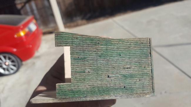

    I think it has to do with posting directly from my phone... currently no Internet service to the house... I followed the directions as posted, but as soon as I select a photo it just bumps me back to the forum without the photo
  • probably the file size is too big. Try an 800 px wide 72 dpi pic....
  • Got it.... needed to resize.... color is Ivy green

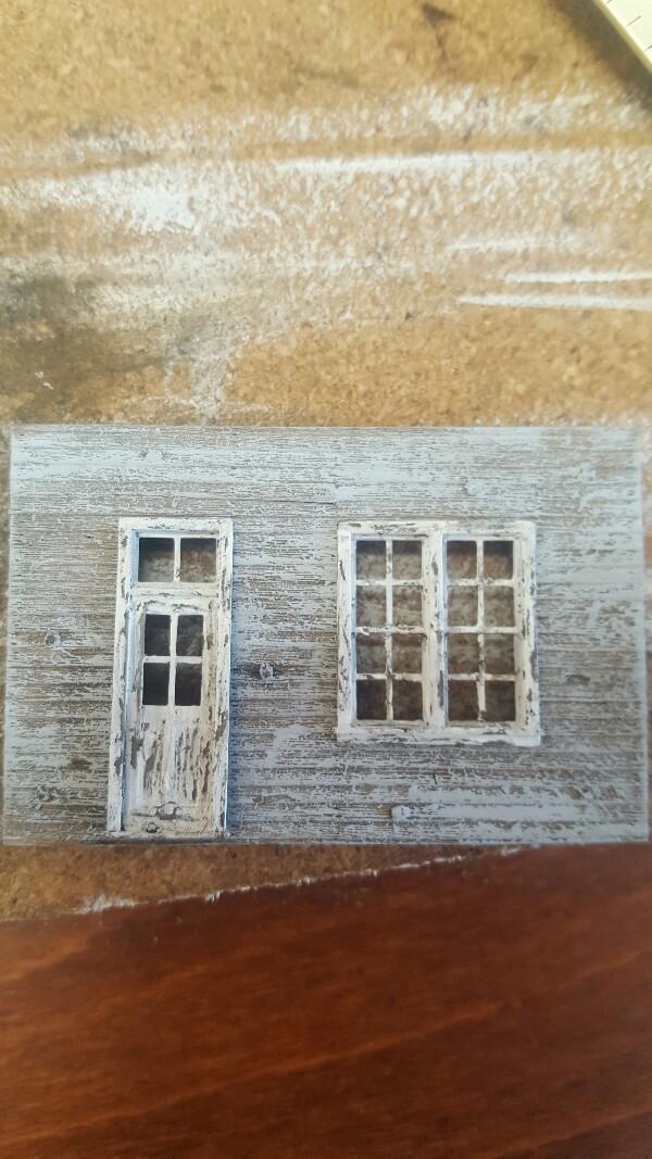

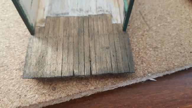

  • The last one is just chalks/rubbing alcohol and some AI solution.
  • No need for you to be concerned. You get it. Nice subtle weathering, nothing is overdone. Very well done! Keep at it...
  • I do like those decking boards, knots and nails are not over done, a few broken boards and the darkened edges blend well. Nicely done.
  • Thanks guys.... got a bit further with that one over the weekend, then it will be on to the good stuff!
  • Mike, I like the wethering on your clapboard. Subtile nail holes and few damaged and loose boards but nothing overdone like Brett said.
  • Mike, You have done some good reaping. Pretty cool having caring people comment on your work?
    Thank you, I was hoping for more of a peeling paint look here, but I do like how it turned out.

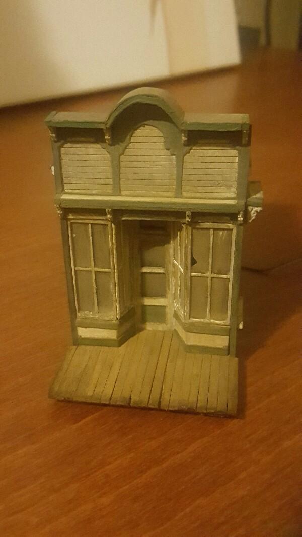

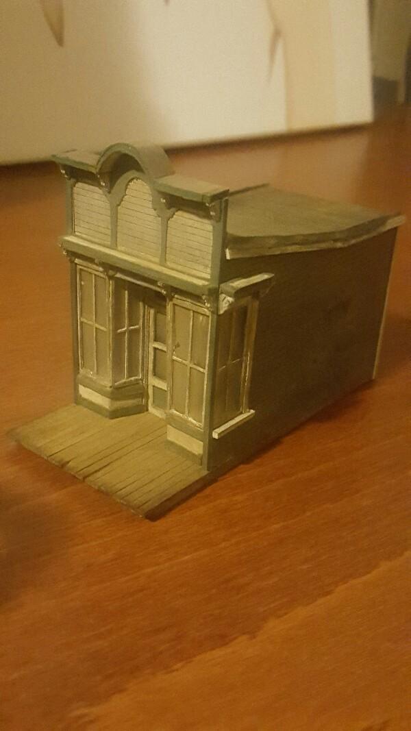

  • The lighting gives the pic a yellow tone... couple minor details left, I want to practice signs like what would be on Oniels, and some more weathering with chalks. My second order of chalks will be here any day now.
  • edited April 2017
    Good precursor to the O'Neills build. Dull muted colors look great as do the dirty old windows. May want to try and show some foot traffic wear pattern to the front entrance decking a bit, appears to uniform in color and texture...nice color and texture just a bit uniform.
  • Thanks Ken, would you use more chalk there, or AI solution?
  • edited April 2017
    Its a pity that the quality of who-evers kit that is doesn't make it easy to judge the results, however....
    Grab a chalk a little darker than the one used on the main decking and darken the floorboards in the doorway, think about where people would walk and where grime would be.
    if you go too dark for your eye you can always blend it back in with the original floor colour.
    Never be afraid, there is always a way back.
    A/I is less controllable due to soaking in and wicking, for specific areas (such as the doorway) and patterns I would use chalk, for the edges of the deck where natural discolouration is required with seeping I would use A/I, carefully, build up slowly and review.
  • One little trick to try is put some darker chalf on your finger and lightly rub it over the area you want the traffic pattern, this will smooth the area slightly plus add the darker color...just as foot traffic would. Experiment on a small area first if you want to give it a go.
  • Sweet! Thank you very much! It will be Sierra West stuff from now on though.
  • Great tip Ken, the darkening along with the burnishing/smoothing would be perfect for high foot traffic areas.
