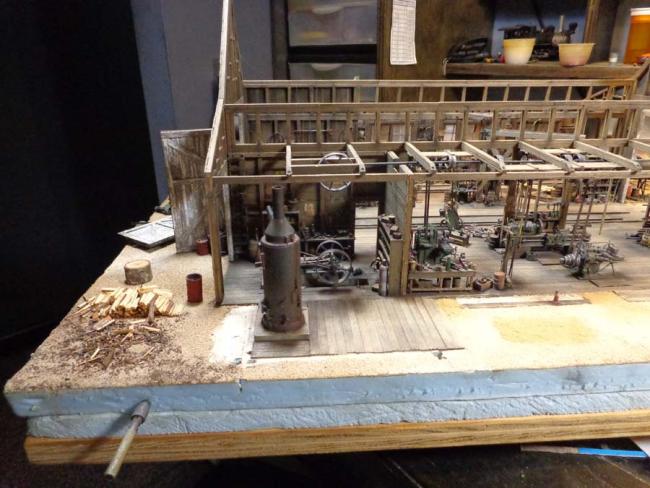

I finally got started on the project a few months ago and have made some progress. As things seem to be relatively quiet around here on the forum just now I figured I would post some updates of where I am on this build for the members here who might enjoy seeing it progress through to a completed diorama.
As always with my builds here on the forum please join in with any comments, ideas, criticisms, questions and just general input to the thread. It's always great to know that there is someone out there, following along.
I'm quite far along with many aspects of the build so the thread here will be playing catch up with me for a short while. This does not mean however that things are now 'set in stone'. I am always more than willing to redo a finished item if there can be a significant improvement, so, jump in and join in.

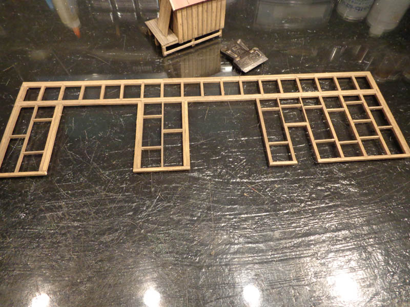

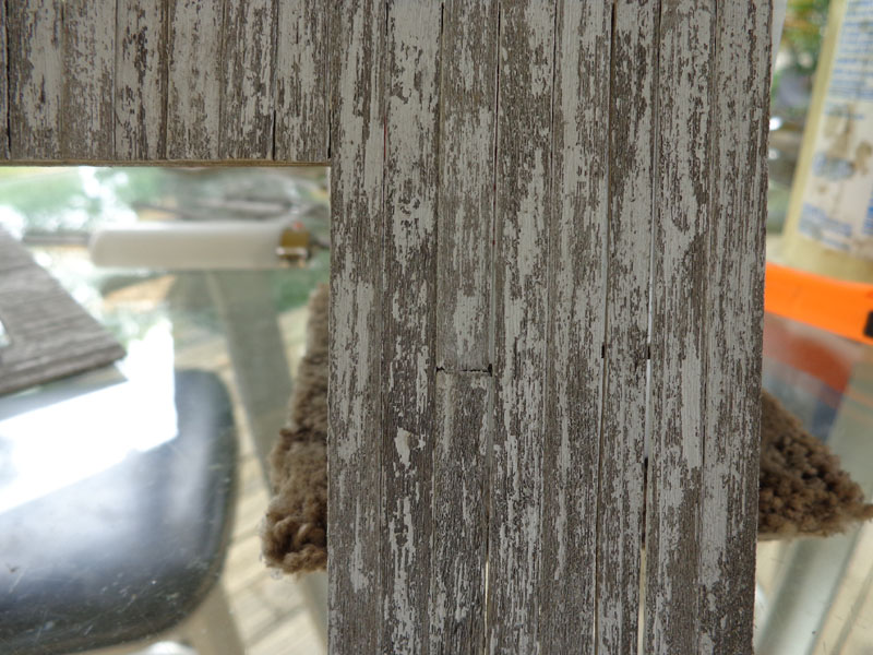

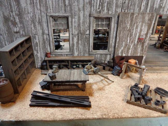

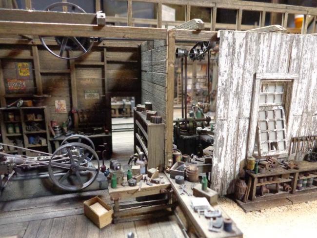

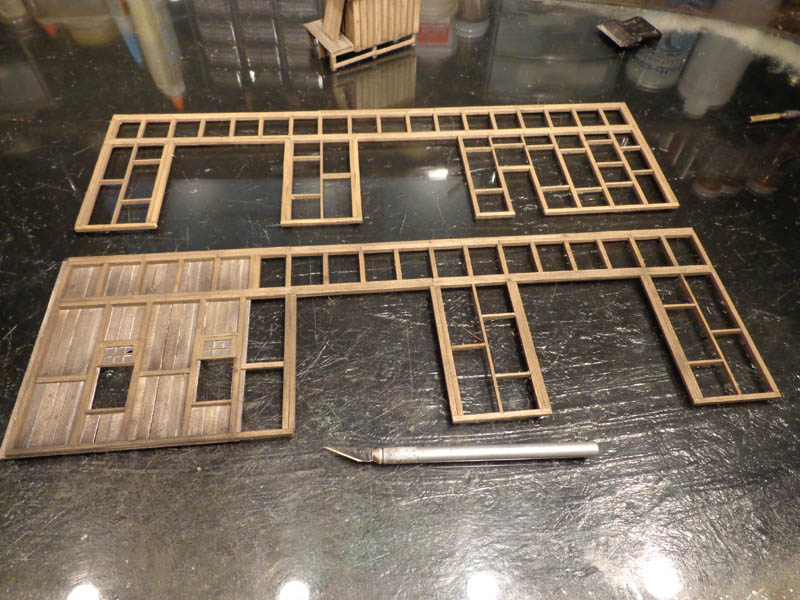

  • Well, I thought I had taken progress pics of the walls being assembled but they are proving to be elusive tonight. Essentially I am following the sequence and techniques from the outstanding manual. Just with bigger wood....

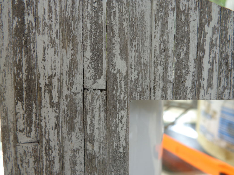

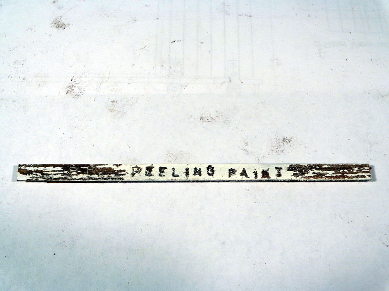

    To begin with I redrew the framing for the walls in CorelDraw and printed them off as templates. The walls were then built using stripwood precoloured with C&A. I used 408.3 for the framing.

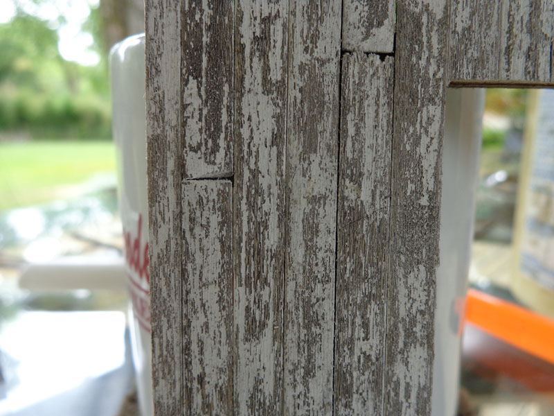

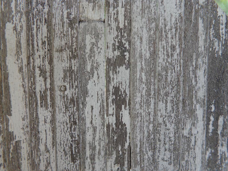

    The walls were then sided with 2x12's. The strip wood was coloured with grey on one side for the exterior and 408.3 again for the inside. The peeling paint technique from the manual was used to achieve a weather beaten finish as below.
    Although I knew the exterior would be painted I still added knots as I knew they would be visible on the inside and also I was hoping for some interesting effects through the paint, several are visible here.
    I was pretty pleased with the way the effect came out.

  • The peeling paint and grey are perfect. Presumably this is a "hairspray" and light sanding method?
  • You dont get much more realistic than that. WOW.
  • Amazing....Joe CCCModOn30
  • Looks great Karl......looking forward to the build
  • Thanks for looking in and the posts James, Wes, Joe and Scott, good to have you along.
    ............ Presumably this is a "hairspray" and light sanding method?
    James, this is actually the mineral spirits and tape method as described in the manual. It's a fantastic technique and very controllable with some practice. Which makes it applicable to HO as well as the larger scales.
    Sanding would give a more worn/faded look due to the abrasion as opposed to a lifted/peeled look with the tape.

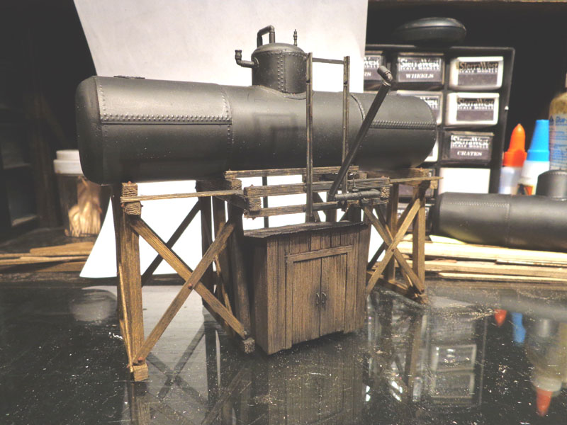

    Although the Oil Tank is pretty much finished as previously mentioned and several of you have already seen it, here is a recap of the build as it happened for those members who haven't seen it.

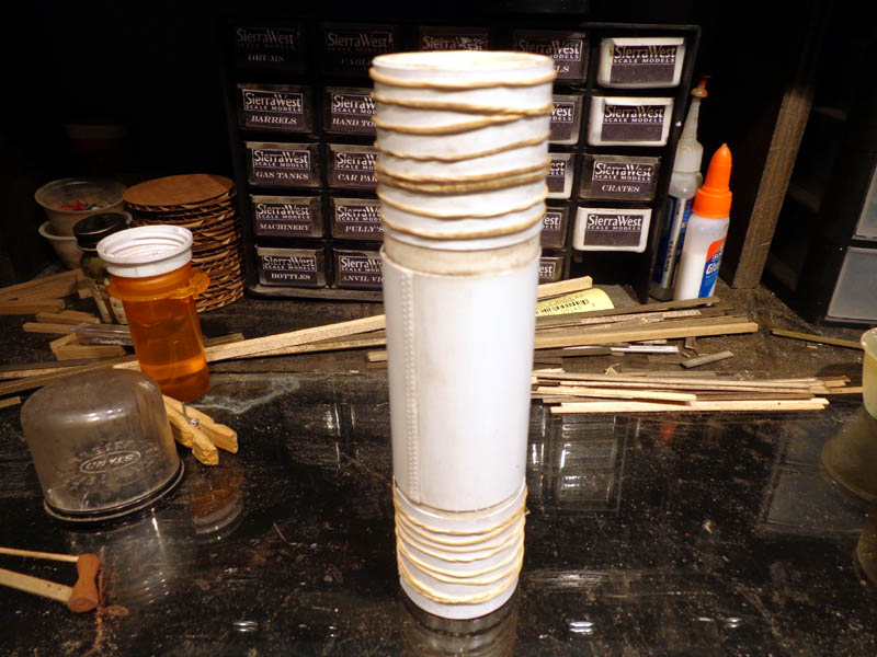

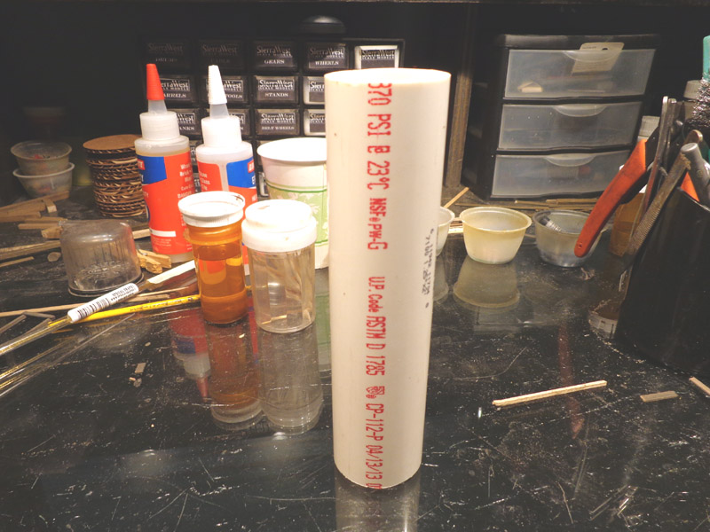

    The basic form for the Oil Tank is a section of PVC tubing. Sizing for this was based on the HO version.

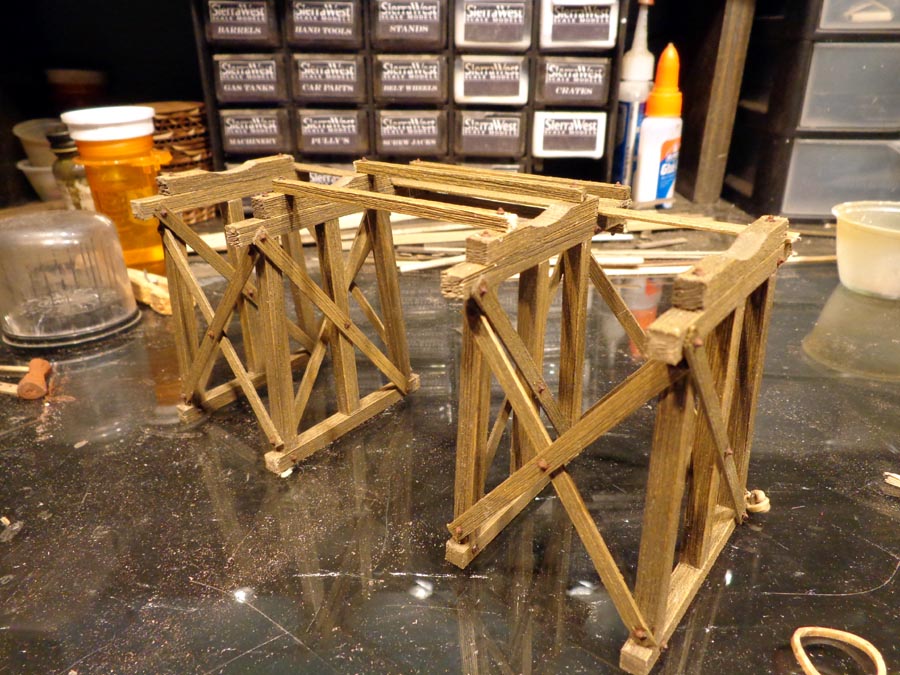

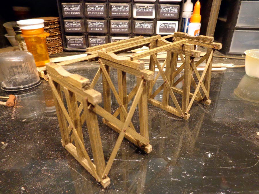

    The support framework could then be built.
  • Looking great Karl.........if possible could you describe the peeling paint method , or point me to the thread that discibes it?I can't work in ho scale anymore so can't enjoy those great kits.Love working in o though so all is not lost.
    looking forward to the rest of the build keep up the great modeling
    Scott
  • edited December 2013
    Thanks Scott, I'll see what I can dig up for you.

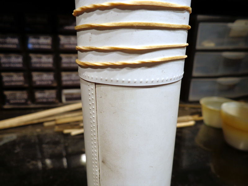

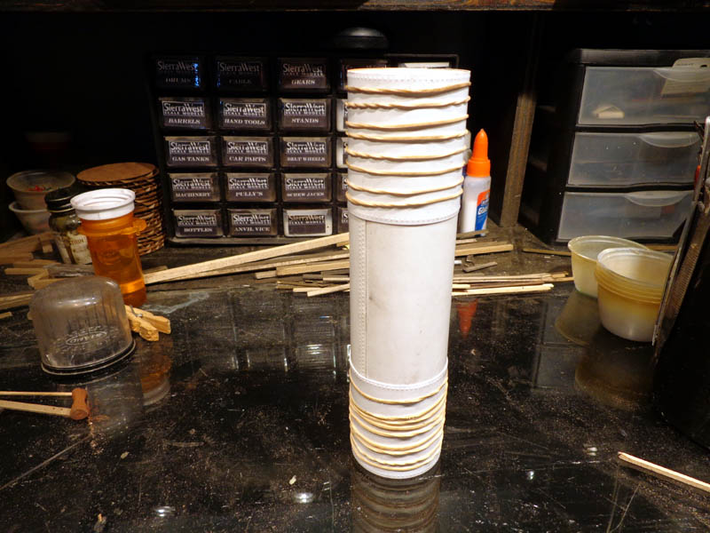

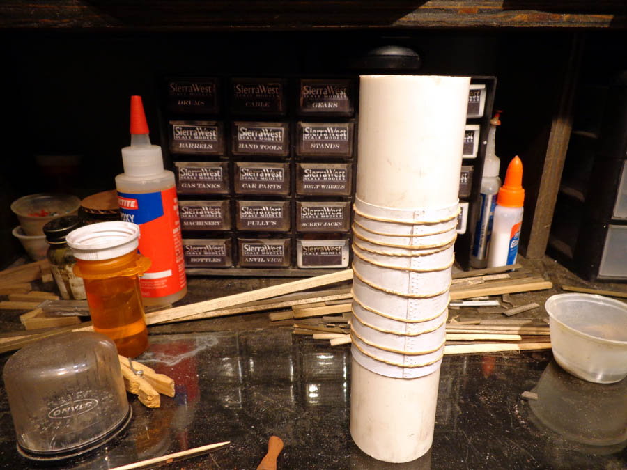

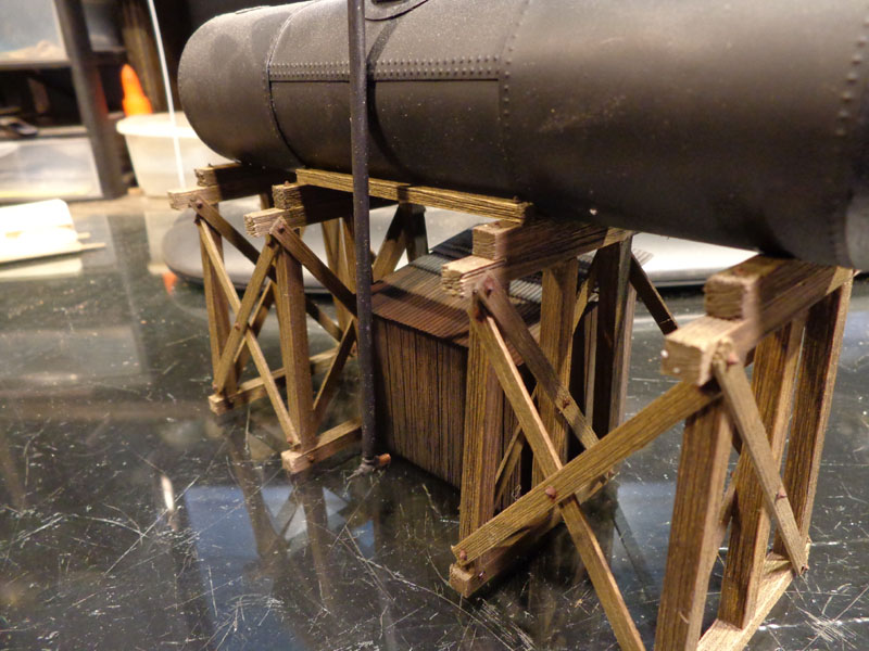

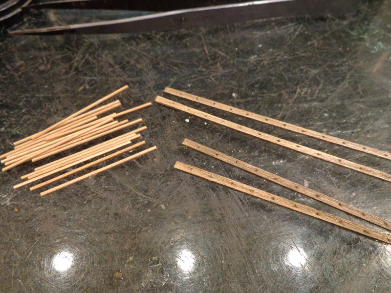

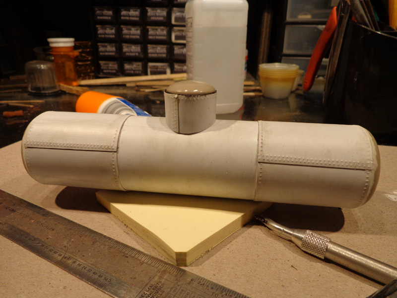

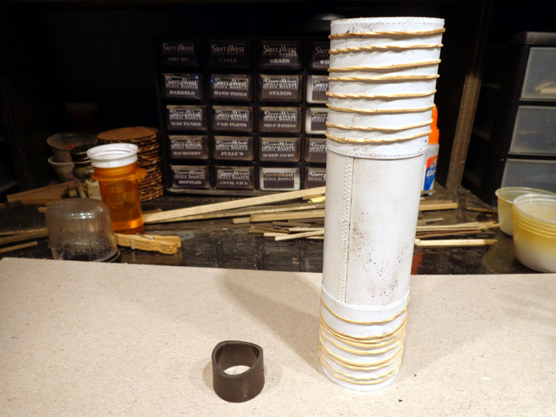

    I used some .005 styrene to make the metal sheets of the boiler. Rivets were added with a pounce wheel.
    The styrene was glued with epoxy and held in position with rubber bands. A very messy business !
    I had to install some spacers on the ends to avoid a taper on the next sheets.
    The outside panels were added in the same way.
    The dome was made from a smaller pipe found in the garage.
    Wrapped with riveted styrene as before. I found some furniture sliders of
    the right diameter for the rounded ends of the tank and dome
    Test fit.
    Next up was the flanges, gluing the components together,
    clean up and a coat of paint.
  • Very cool! - I had no idea one could could make rivets with a pounce wheel- or tank ends from furniture sliders!

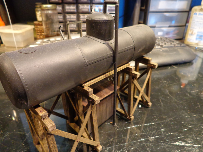

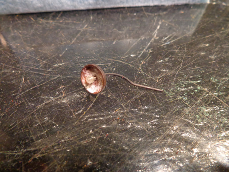

    Some flanges were made from more styrene and rivets added. One for the main dome and one for the filler pipe.
    I also made a couple of round plates, not sure what these are for but I've seen them on tanks so I made them....
    Everything was epoxied together and all the epoxy ooze and finger prints were cleaned off when dry ready to paint.
    The tank was painted with cheap rattle can spray paint from Home Depot, 99c can and very fine coverage.

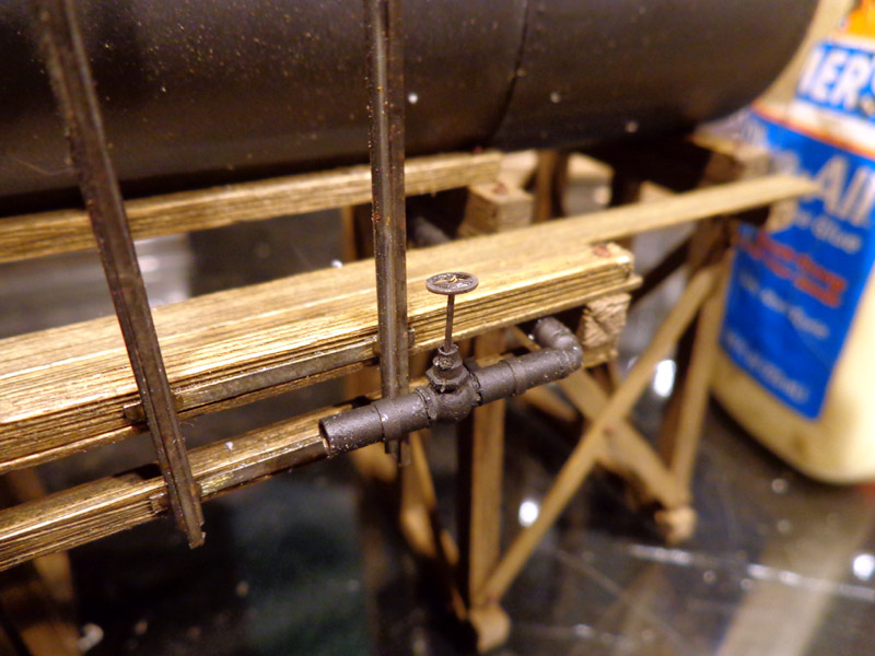

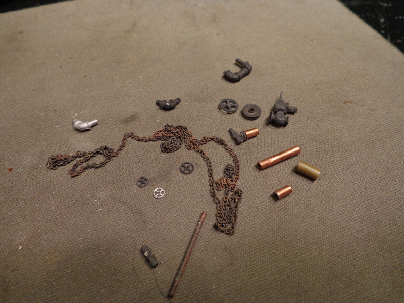

    I then started working on the piping, Some were adapted from the SierraWest castings and some were made from scratch.
    Some more progress on the pipe fittings.

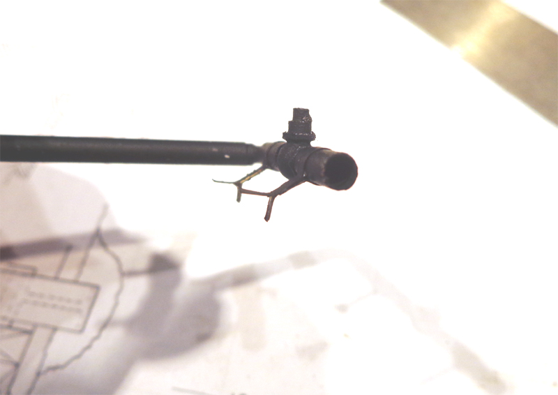

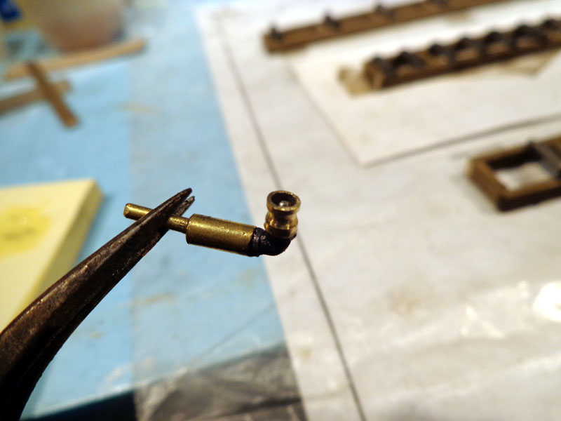

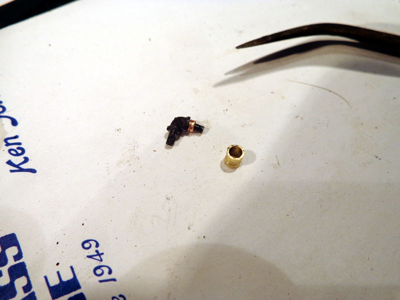

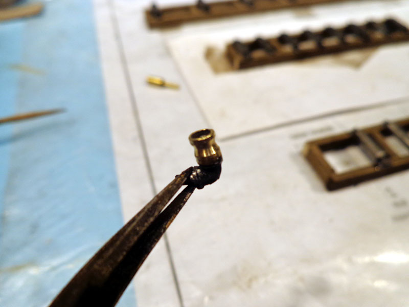

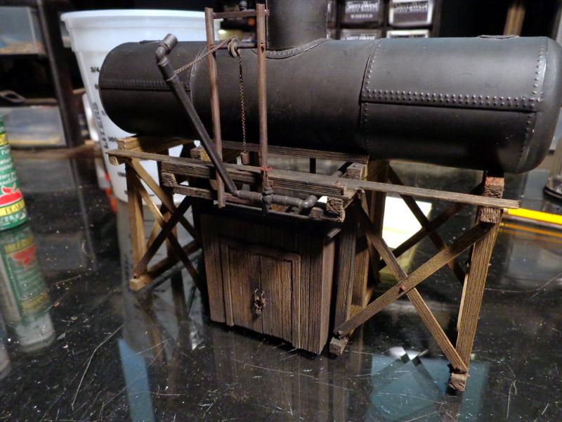

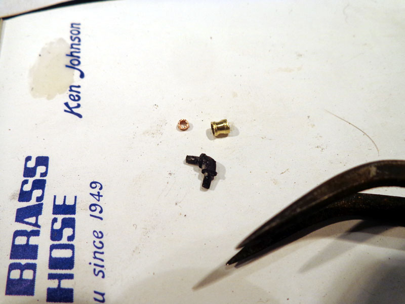

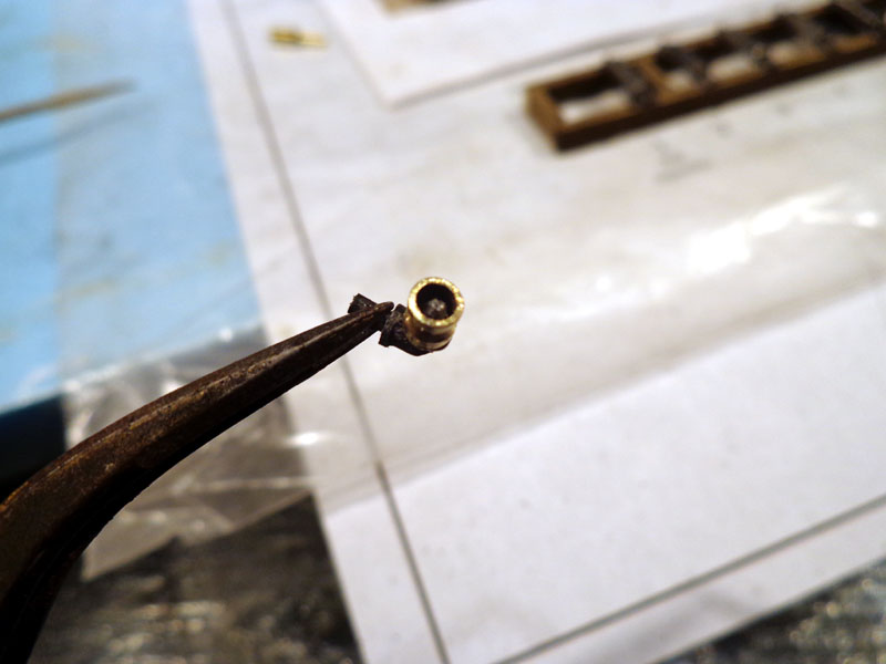

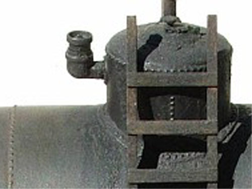

    I noticed while studying Chuck Doans incredible model (shown below) that the tank fill tube was not just a simple pipe, it had some interesting detail and shape.
    I set about re-creating this by adapting a SW elboe casting.
    I added a copper sleeve spacer around the nipple and then filed the nipple down considerably.
    I placed the 1/8" brass tube in my dremel and turned it using a jewelers file to obtain a "waist" in the pipe.
    When fully assembled I was happy with the look that it gave to the fill valve.

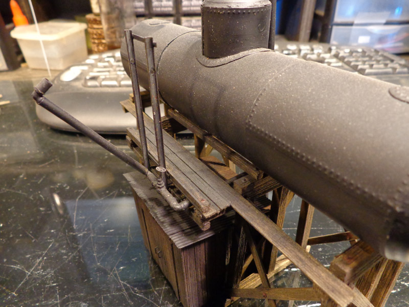

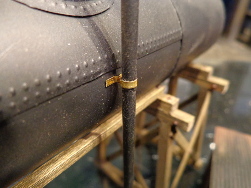

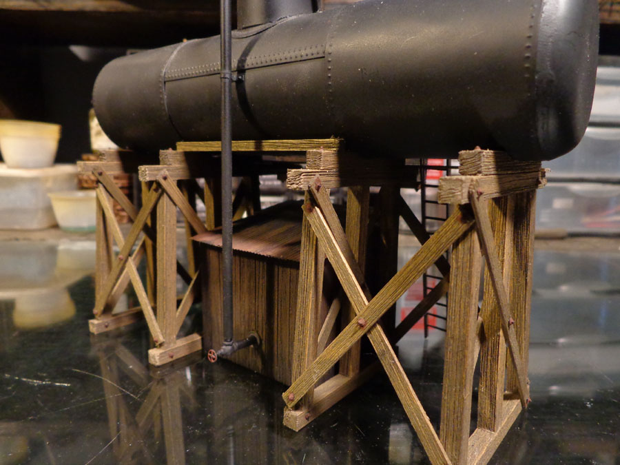

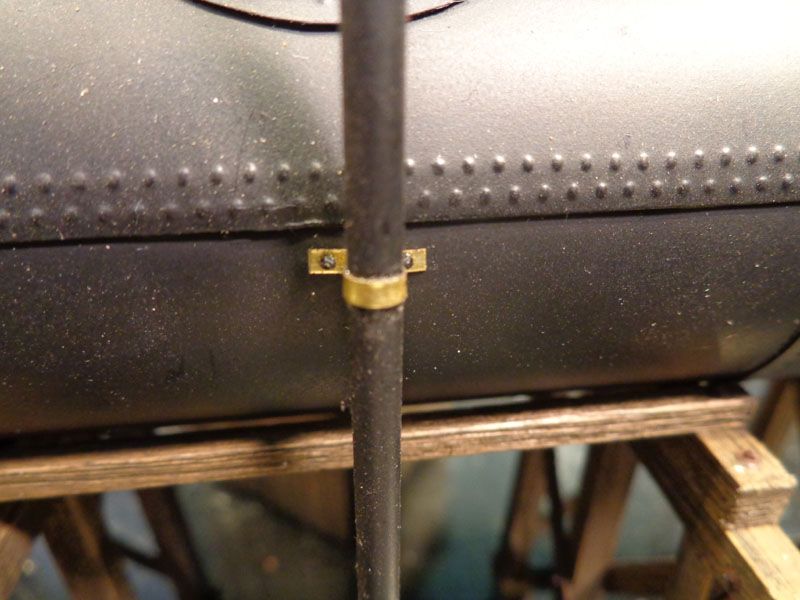

    I next moved on to making some brackets from sheet brass to hold the dispensing pipework away from the platform.
    Unfortunately these are not visble from most angles, however the bands around the pipe are, and atleast I know they are there !

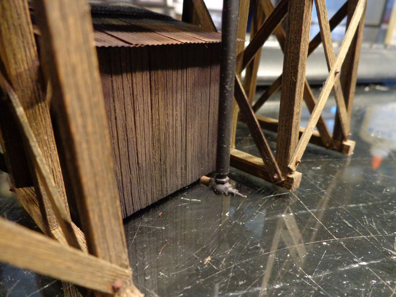

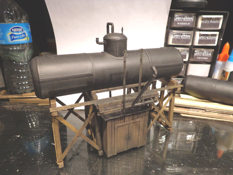

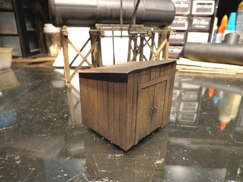

  • The next step in construction was building the pump house.
    Various elements of the piping were then test fitted.
    Some more brackets and things were made from brass sheet.
  • edited July 2017

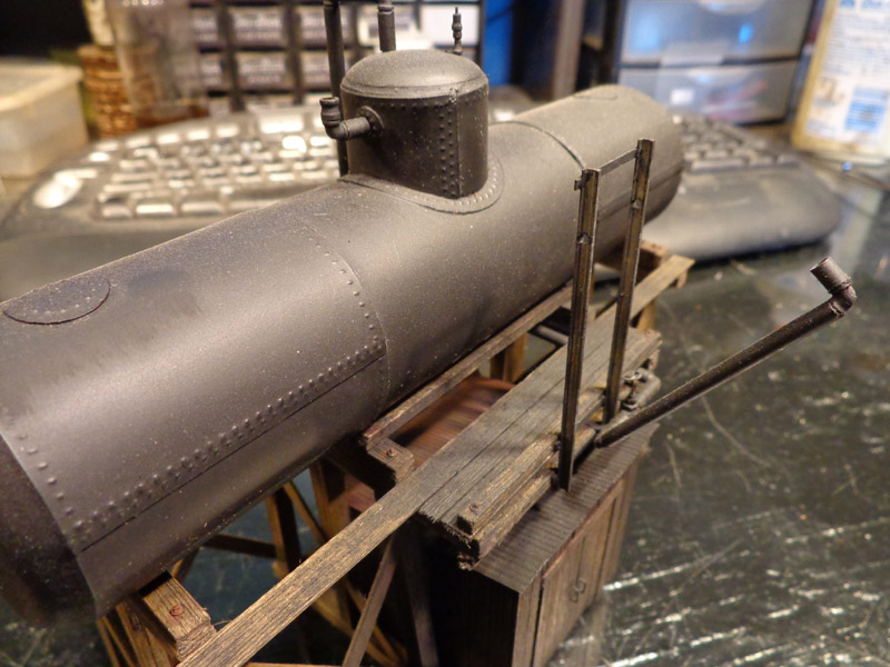

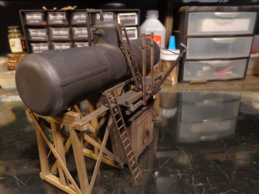

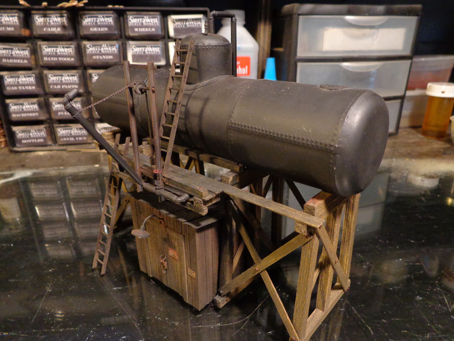

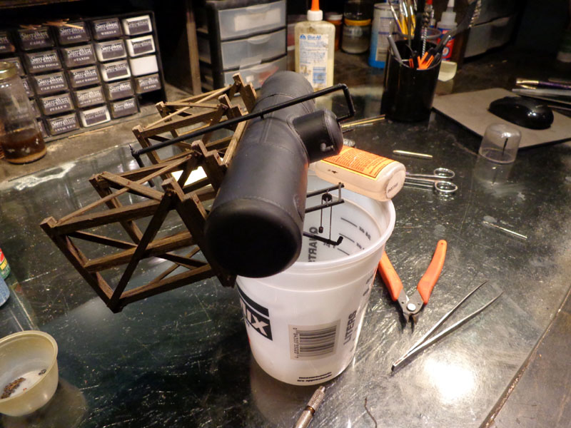

    The tank needed to be balanced at a precarious angle ontop of a container and a bottle of glue to keep it in position until the glue on the chain dried.

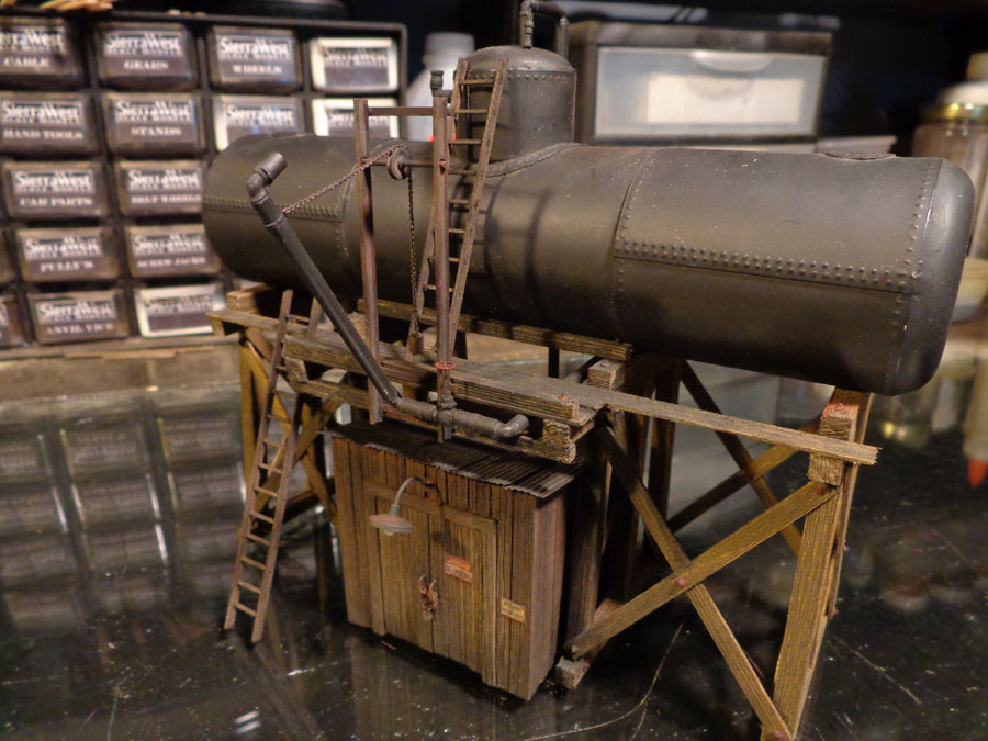

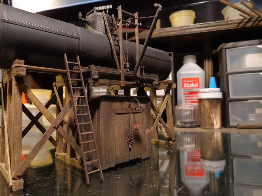

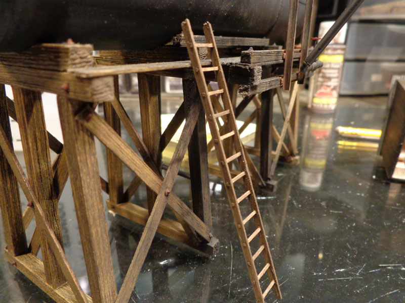

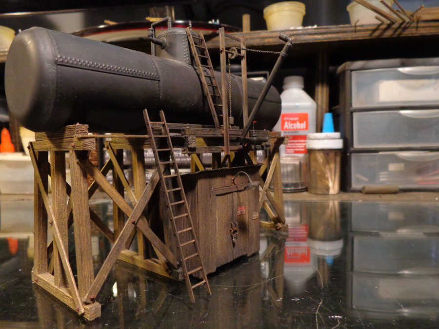

    Next up was to make the access ladders for the tank platform and up to the dome.

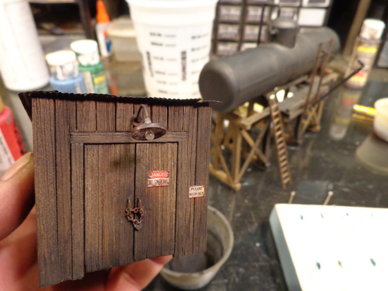

    A lampshade was added with a scale light bulb to the pump house.
    That is how it will sit until it gets installed on the diorama and the tank gets weathered and everything gets touched up and blended in to the scene.

  • Beautiful - almost overwhelming (of course as u mentioned u haven't built this all in the last few days! - please tell me u haven't ! ) So many questions - did u set up a jig for those ladders? They look fantastic- keeping the rungs square would be tough. Love the lock - is it a photo- etched detail? The piping is great. People have to remember that even in o scale these are really small details. I guess one can't have enough K&S tubing and sheet material bits lying around!

    James, the tank took a little under a week. There wasn't a jig for the ladders, in the past I have made the rungs round as they should be, this time I got lazy. The padlock is a CHB detail part.
