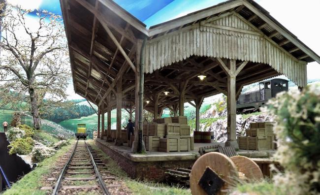

I started this scratch build project for my next diorama (which will include SW ) last august. So don't think I have a secret device to speed up builds.... :)

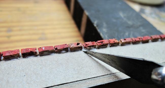

A wooden hangar, old wooden trusses,, concrete (cardboard) floor, corrugated metal and brick wall. This time the bricks are made, one by one, out of cork. A matter of exploring different techniques And of course, functional lightning...

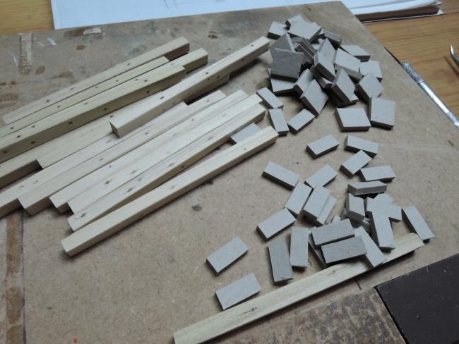

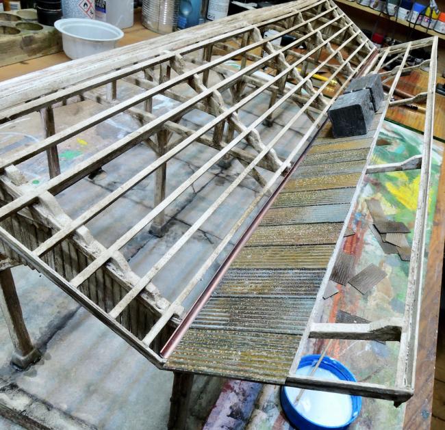

  • Some ' behind the scenes... photos

    Great modeling and an interesting subject. I don't think I've ever seen an overhang (1:1 or in scale) constructed like that. I'm assuming they wanted cover for the loading dock but it would hang too low and interfere with rail cars if it was constructed any other way.

    Cool idea with using cork for the bricks. What type of cork did you use? I was thinking road-bed cork, but the pictures above look much smoother than that stuff.

    The cork is just wall decoration cork 1,5 mm which I prepared with diluted white glue in a way it got stronger . This to prevent falling apart when cutting into tiny pieces. Like bricks...

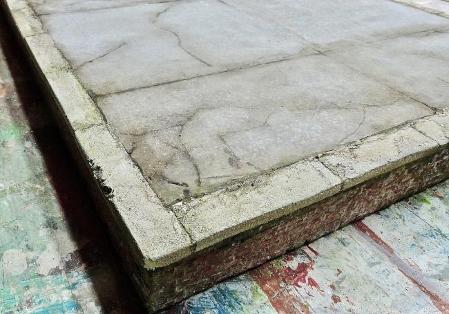

  • Fantastic work as always Robert. How did you do the concrete? The color and texture is great.
    -Steve
  • I used real cement and plaster. On top of, that some washes and pigments (chalks)

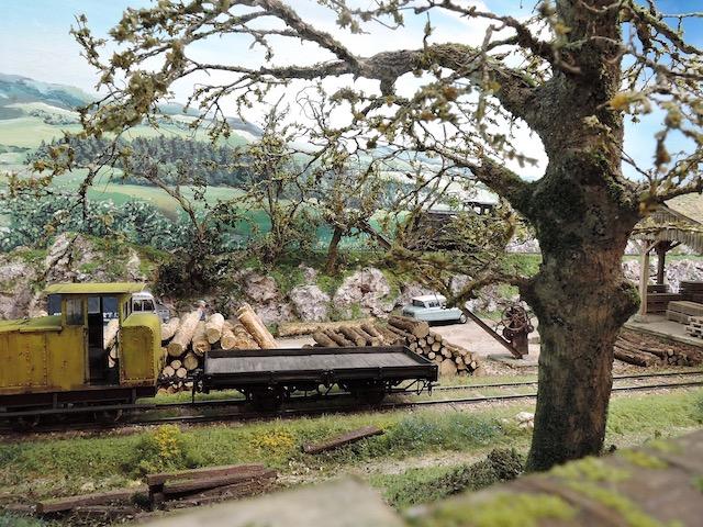

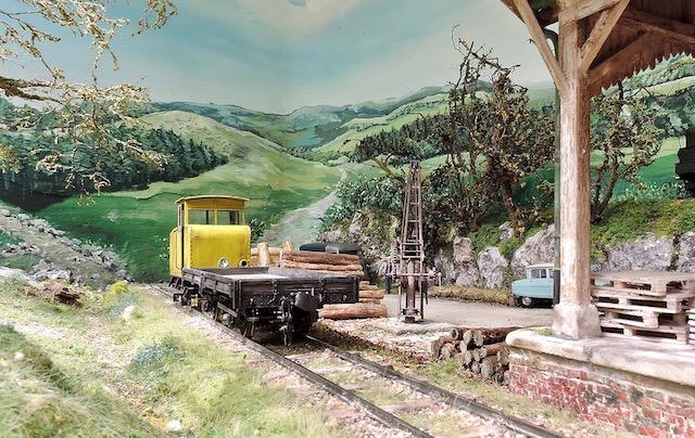

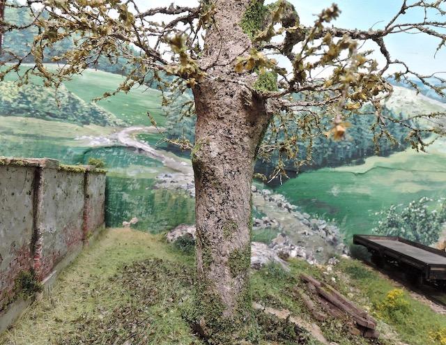

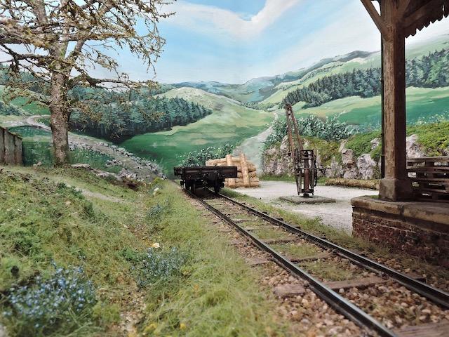

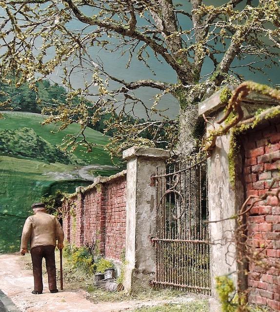

  • Whilst working on the Sawmill, here are some photos of the finished Goods Shed ( we say Hangar) diorama. Everything is scratch build. The rolling stock are brass kits. (1/43,5)
    Title photo

    ending photo
