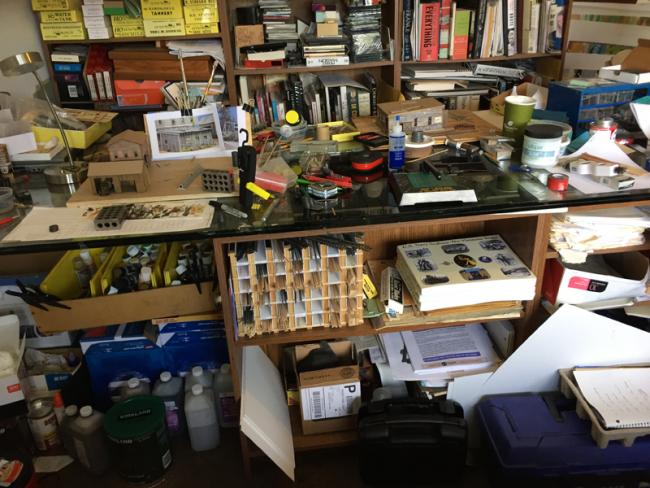

    Work Area
    I use a piece of 36"x108" x 1/2" thick tempered glass which was from an all glass door I took out of a renovation project...they're more common than you might think...keep you eye open for an existing storefront being renovated

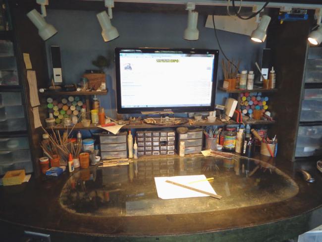

  • Glass top from an old coffee table inset into the desk. Thick, tempered, beveled, free.
    001
