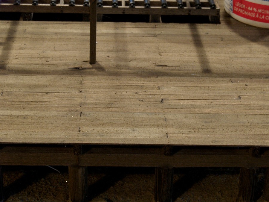

  • Hi guys...this is a picture of my nail holes as MuddyCreakRR has mentioned by using a pin to make the nail marks but I hadn't thought about a little rust. That could be made by sticking the pin into rust powder or chalk and inserting it into the nail hole. I'm going to try that....Davidimage

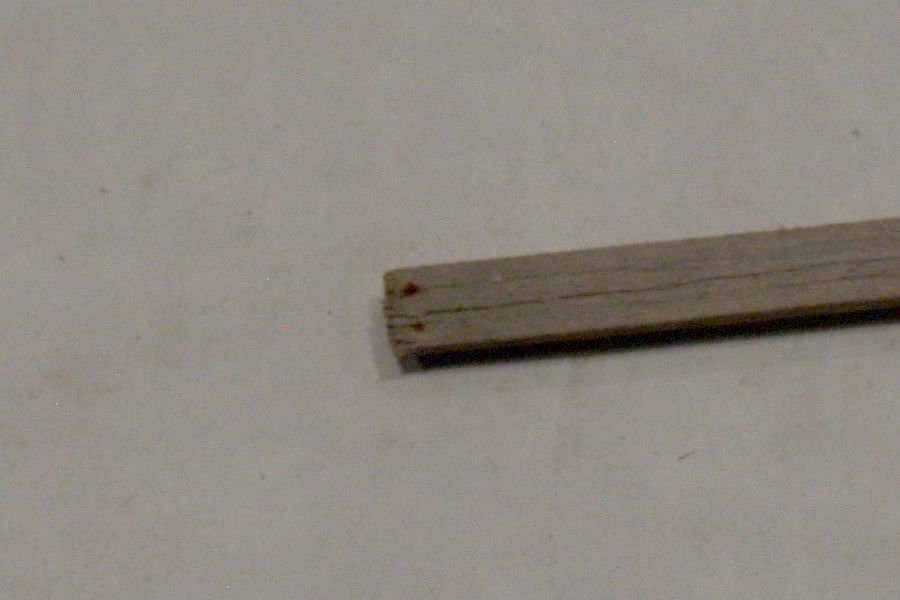

  • I took the pin, dipped in alcohol, dipped in rust colored chalk. then pushed the pin into the wood. What do you all think?image

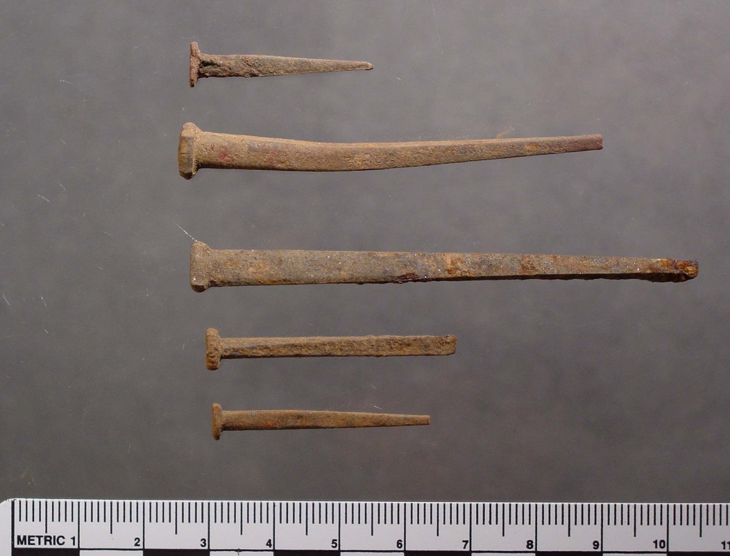

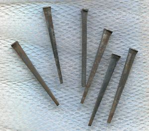

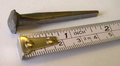

  • David, good idea, worth playing around with, and I like the look. I went "out there" and found some images and a web site on nail making from the 1900's, and they had mostly large flat ends that look to be closer to 3/8 to 1/2" across. http://www.glasgowsteelnail.com/nailmaking.htm
    They were also square, not round. Now I think we have a prototype for the large nails that we can use.
    Those 1/2" nails would be about the same size as the .2mm in HO scale. So they might work after all.

  • I think the rust effect looks nice . . .
