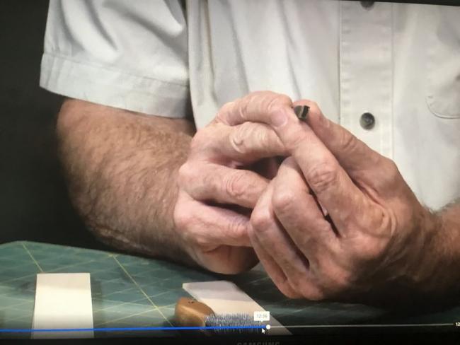

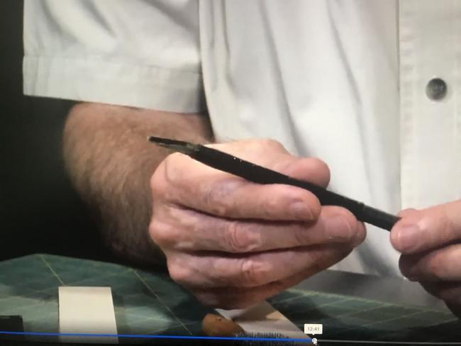

  • I finally found what you are looking for. It is known as the wood wrecker. It is made with either 5 or 6 #11 Exacto blades press fit into the end of a K&S 3/32 X 3/8 brass tube. It is shown in a working with wood video. Here are a couple screen shots I took with my camera so a bit blurry but you should see what you want. do wrap the tubing with layers of tape for a handle.
    wood wrecker
    wood wrecker 2

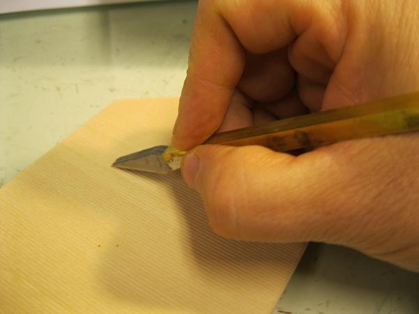

  • If you turn the tool backwards and use the backside of the blade, it digs pretty deep. You can put too much pressure and damage your board. I use a single blade backwards to do damage to board ends next to the ground for dry rot.
    Rick

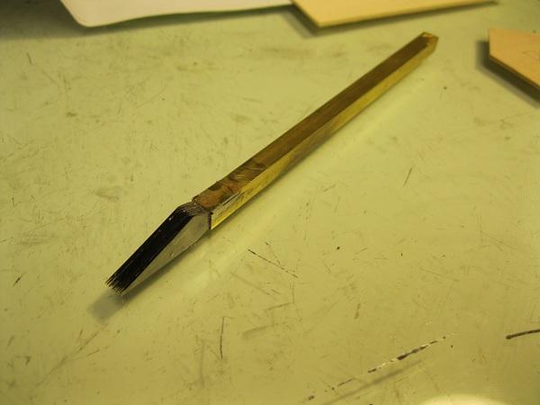

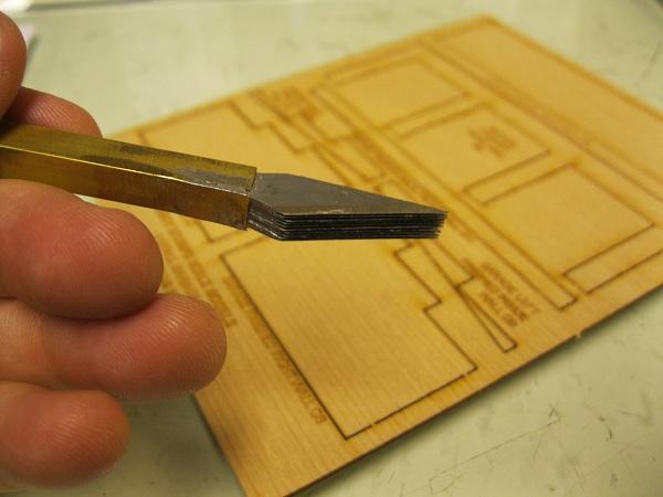

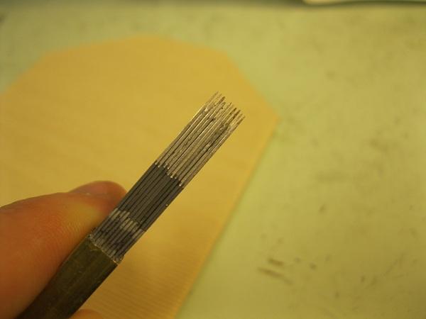

  • I think Mountaingoat is on the right track. I found some pics on Railroad Line but no information on how it was made. It looks like he used square brass tubing for a handle. A stack of #11 blades soldered together at one end and then jammed into the tubing:
    2013105175839_IMG_2716
    20121114221553_IMG_2171
    2012111422172_IMG_2172
    2012111422185_IMG_2173
  • Please keep that away from Kevin. There is one actor on Billions that would dig it.
  • that's exactly what i was looking for. thanks fellas. ed i have no idea what you're talking about.
