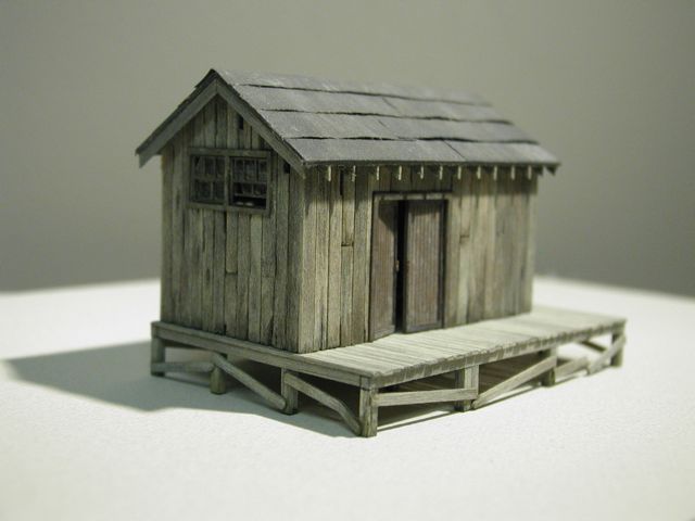

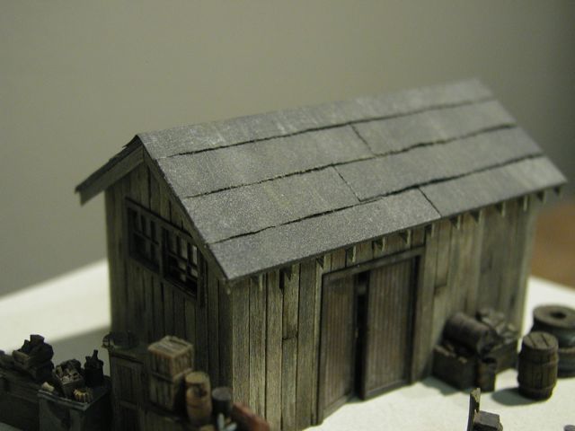

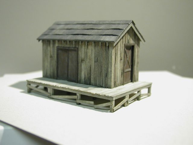

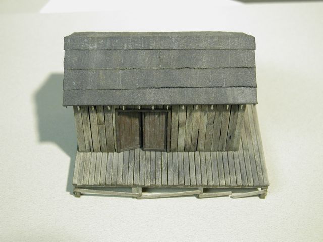

Featured here are some pics of my first Sierra West build. I am planning an early 1900s logging railroad in HO scale. I am starting out small with the Tool Shed and Line Side Storage Shed to get my feet wet with these great kits. My first four walls are completed less doors and windows. Mistakes were made but I'm trying to keep them to a minimum. I was attempting to follow Brett's suggestion in the manual with the Tool Shed build regarding coloring but inadvertently strayed a bit. The siding should have been a bit lighter with an aged and faded red siding. I started with the Grime wash and then began a light brushing with a brass brush and was amazed at the transformation! May have got a bit carried away as the siding got a bit dark. Also, may have weathered things a bit more harsh than I wanted but it doesn't show up as much without the zoom. Spacing on the siding looks a bit generous in spots and I did not plan the spacing where the siding meets the doorways as well as I would have liked. Comments are welcome and please be critical as I'm having a blast learning and am totally hooked on these builds. Will continue updates with windows,doors, roof, etc.. Tried a few nail holes and will finished those as I think they look OK.

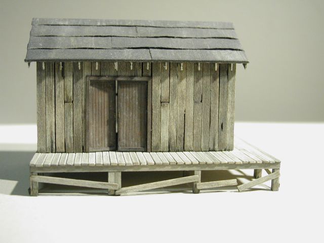

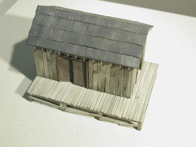

  • Wes/Karl :

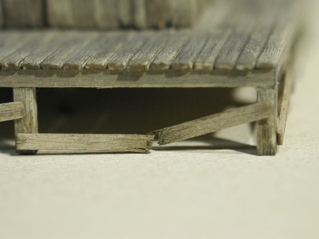

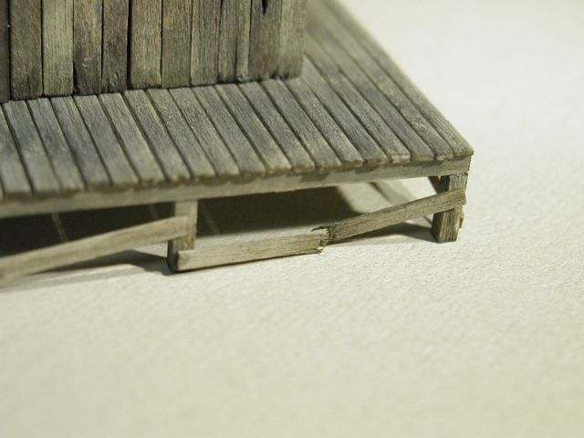

    Thanks for your comments. Coming from you guys it means a great deal. I know I need to crawl before I can walk and I'm humbled by the builds I have seen from you all. Questions; Would you weather the platform more, less, or about the same as the shed siding? I'm inclined to think the weathering would be more on a horizontal surface than a vertical one. I would think the spacing of the boards however, should be close on the platform? Also, foot traffic on the platform would keep the boards a bit smooth? No stairs are shown and leads me to believe the platform is a one step up from ground level?
    Will post the finished walls and some casting work soon. Thanks!
  • Excellent job on the walls. Coloring has a nice dull gray. I agree with Karl that this could easily pass as O scale.
    As for the platform, I always prefer to use the same palette as the walls but make it more gray and a little lighter to simulate the sun beating down on that horizontal plane. One technique I sometimes use for this is to lightly sand with a 220 grit paper before or after building. For me this really ages the board and highlights the edges and grooves in the wood.
  • Bryan,
    Thanks for the feed-back on the walls. I totally agree with your thoughts on the platform and will be building with the plan to keep the platform same palette but lighter/faded and will try the light sanding as this should also smooth the top side a bit as you would expect a foot traffic area on wood to be. Thanks again.
  • edited January 2013
    Ken, as yourself and Bryan have already discussed I would also treat the decking slightly differently from the walls.
    I personally try to make them look a little greyer and sun faded as has been noted. I use steel wool to lighten, smooth and 'polish' the boards, this gives a really nice worn effect that I like.
    As for spacing I leave a very small gap betwwen the boards, for drainage, take a look at the O scale BlueSky dock for an example.
    Keep us up to date on your progress,
  • Karl, Thanks for the suggest as it looks like the light steel wool may give me both the lighter color as well as the smoother worn by foot traffic feel. I have been struggling with getting the dirty window effect. The dusting with the light chalk seems to come up smeary rather than that even light coat. Might be using too soft a brush and when I dab, the tips are bending creating a smear effect? Will be posting soon once I sort this out.

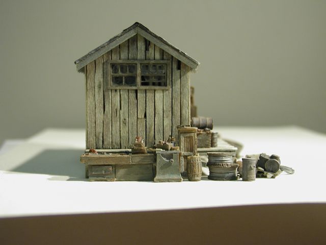

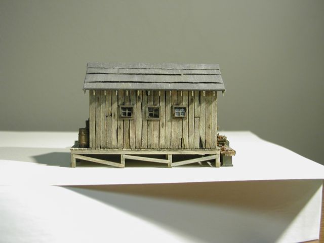

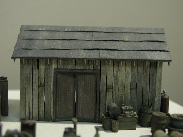

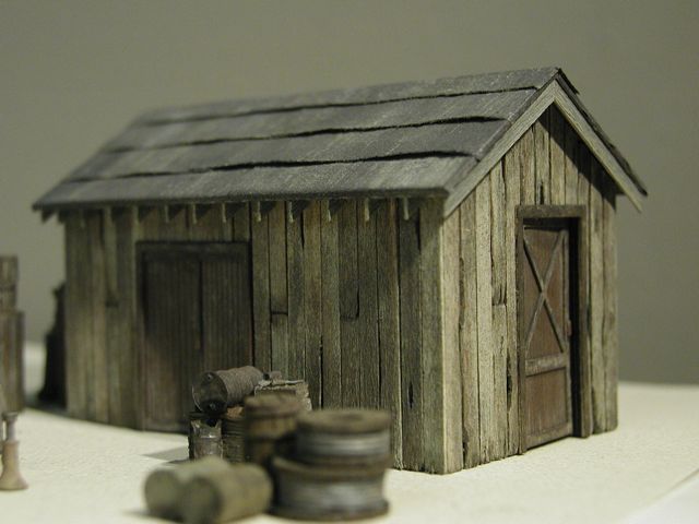

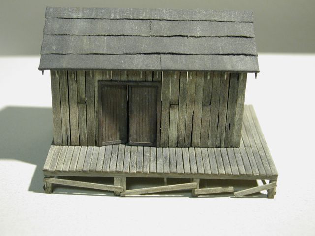

  • Here are some pics of my "finished" walls for the tool shed. I have the two side walls glued to each separate long wall but have not done the final gluing so I can re-work the windows a bit. Thoughts on the windows?? Not real satisfied as I had trouble with the homogeneous "fogging" with the chalk so I decided to make it appear as if the dust has collected along the edges and corners simulating someone half heartedly cleaning the windows with a shop rag. Roof and Rafters are next with some pics coming on the castings.imageimageimageimage
  • $##%^%&*, Sizing issue, Geesh!
    Here are the pics...
    Kenimageimageimageimage

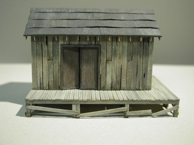

  • Ken-
    Way to go on your first SW kit! Very nice look on your boards. Color and texture are spot on. Did you do anything special other than the brass brush to get that rough-sawn look? It's very convincing. Knots and nail holes all look good and you've got real nice definition on the slats of the doors.
    As far as suggestions, most have already been pointed out. When spacing boards for walls, I've tried to go no bigger than a business card or a razor blade to size the gap (that's in HO). When you add the view block of black construction paper it will help prevent seeing all the way through the building.
    This is very good work--you should be proud of it! Have fun and keep posting pictures.
    Bill
  • Bill, Really nice to hear from you! You are somewhat of a legend with your Twin Mills build. Gee wiz, I must have looked through that thread a dozen times. Not only the build but your diorama was ridiculous. I learned so much just following that build. Then of course there's Brett's manuals...
    Anyway..I used a brass brush ( 1 x 3/4) with 1/2 inch bristles so for the wood it was a bit big with the bristles a bit stiffer than the smaller brush. I brushed both before the Grime wash and after. I did dry brush the boards the Boxcar Red per the manual so there is a hint of faded red. My final coloring on the boards was darker than I had planned so I went real light on the red just giving a hint.

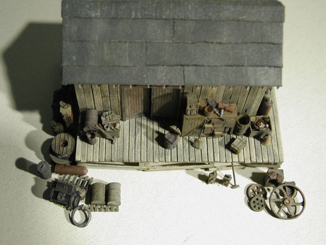

  • Here are a few pics of almost all the resin castings for the tool shed. I haven't tried the metal castings yet, that's next. imageimageimageimage
    Details look great Ken, sharp definition, muted colours very tidy paint work. Very well done indeed.
    As for the windows on the shed I'm not sure what you dont like about them..... they are perfect for old, dirty, half-ass wiped clean shed windows. I really dont see how they could be any better.
    I really, REALLY hope you have left them alone and not tried to "fix" them.
  • Karl, I aint touchen em, and if anyone complains I'll tell em Karl said so! They do actually look good at scale.

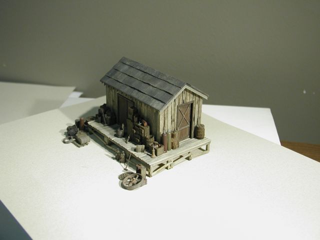

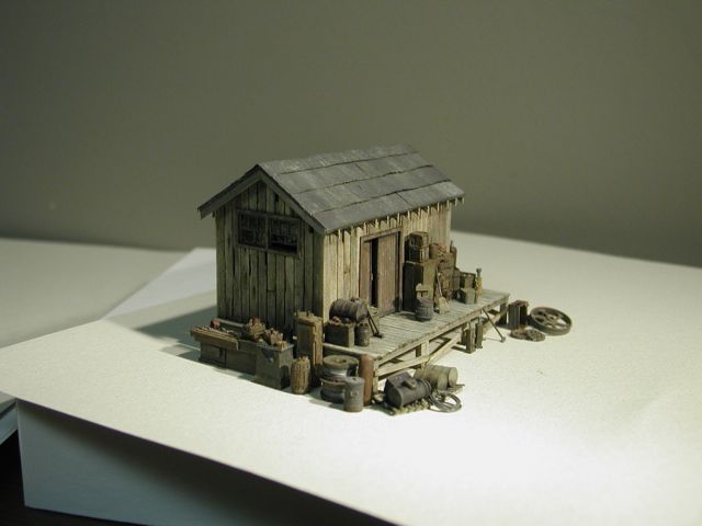

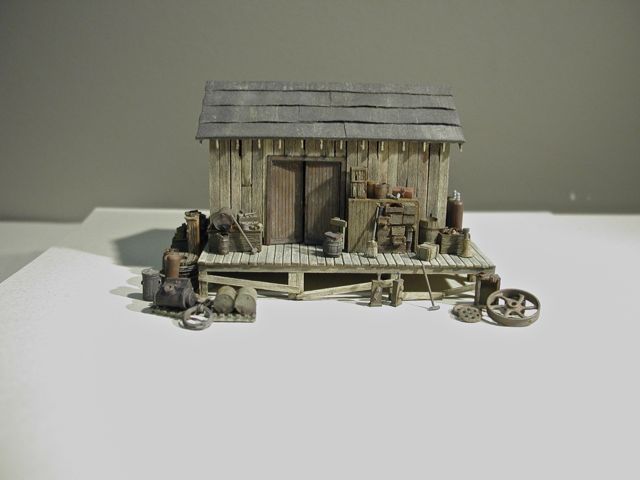

  • Couldn't help taking one more shot of things just set together.
    -Kimage

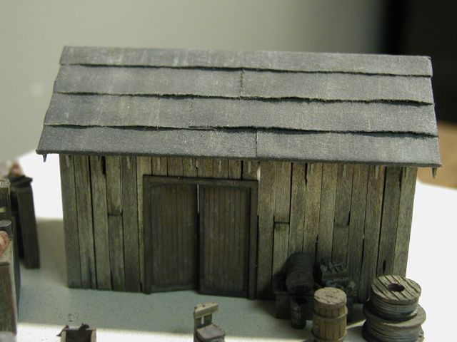

  • Also wanted to try the addition of old oily rags. Followed the manual recommendation and colored paper towel with Box Car Red then a bit of Grimy Black. I glued them to the top side of an old crate. Also figured out the heavy weathering technique on the old drums. I was trying it with my brush too wet with pra. Tried it with an almost dry brush and that was it! imageimageimage
  • Ken,
    you have definately got "the touch"...
    Trying something out and then adjusting it slightly to get the right result is alot of the battle... you obviously have no qualms in doing this, which is showing in your results.
    Very nice.
    Blackening the metal details which are to represent wood, such as pallets, gives the casting some 'tooth' for the base layer of paint to stick to better.
    Also, if for some reason the paint/weathering does chip off at some point in the future you will be left with a dull black chip, which is easily fixable.
    Without the blackening you would be left with a shiney metal spot.... not good at all for something like a wooden pallet.

    Here is a pic of my first go at the metal castings...not sure which I like better working with metal or resin..hmm. Ken.image
  • They look very good to me Ken. I really like the large pulley and the pump. One suggestion for the tools would be to lightly buff the faces to show some wear. As Brett says you get the idea of being subtle and that is huge for a beginner. Very well done!

    Axe edges, hammer heads, gear teeth, basically any surface on any detail that would get wear and tear in the real world, anvils, pully wheel faces, corners of machinery, think about how things are used and look at what is in your garage/shop, or all around you....
  • Thnk "wear points". Anyplace a surface will get rubs, scraps, hits, scratches, ground...
