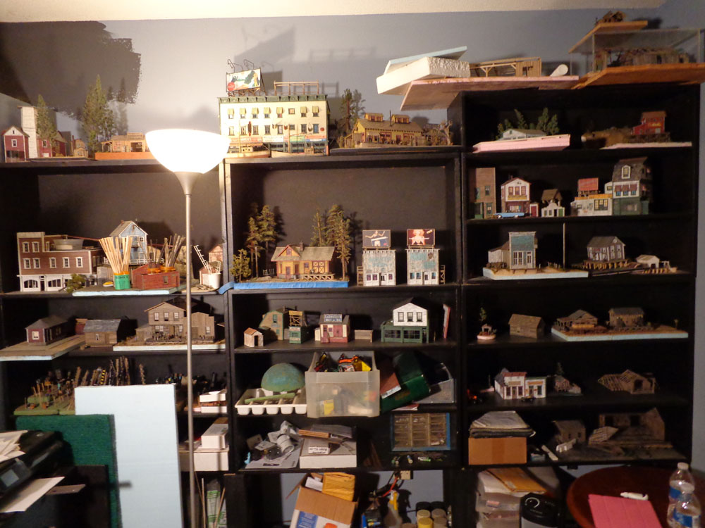

    Ken, I was pretty much thinking along the same lines as you when I started down this road 5 or 6 years ago.
    I was afraid to put the time into making a diorama for the structures as I had the grand master plan of them going into a layout in the future.
    This was the result......
    A bunch of mostly finished bare structures sitting on shelves with no real details.
    As you stated, it can be hard to put maximum effort into a scene when in the back of your mind you realise that you may have to undo some of the work to incorporate it into a layout.
    Here are my thoughts on the subject... right or wrong.

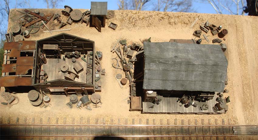

    Over thinking and or planning for the 'future' can really hold you back, so, I have started to build small dioramas on 3/4" foam bases. these can be easily incorporated into a future layout, when/if that happens.
    As you say not knowing exactly where a structure will go can make this difficult so what I have done is make the base the minimum required for the scene.
    Railroad camp is a great example of this.... the base only extends from the structure about an inch on most sides.
    This is enough to build a fully detailed and finished scene but, will not limit its incorporation into a layout.
    My tool and rigging sheds follow the same principal. Although I did add a track section to this diorama I fully expect and accept that I will cut this off when the time comes.
    This will be easily done because of the foam base with a simple sharp knife. however, for now it looks complete on my shelf and some simple scenery blending will make it fit seamlessly into it's final resting place.

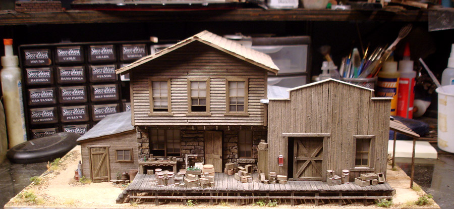

    Even the recent O'Niells diorama only covers the imediate scene around the structure although it is slightly larger.
    My thinking is that I know I want the whole scene in the layout and not just the structure. Although I dont know exactly how the layout will look I do know how I want that scene to look, so now that scene is done.
    The more completed scenes I have to just 'plunk' down into the layout the less space there will be to fill in inbetween.
    So, my suggestion is to build the immediate scene around the structure which you know will be there regardless of where in the layout it may end up.
