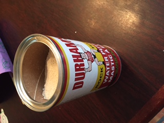

  • edited November 2012
    To add to the discussion. This was a rural road on a former layout. Real dirt on top of Homasote held down with sloppy white glue (dish detergent, 50% water and 50% white glue). Ruts made with an old model vehicle while the dirt was still wet.

    I'm finally at a point where I can start replacing the details and continue with the scenery elements.
    I usually work on a small area at a time laying in the major componants. The first thing to do is wet the area to be worked on. I do this with some "wet water" in an eye dropper.
    The two large containers below are my basic grout mix. I use one part dark to two parts light for my main base layer of dirt as seen previously. The three smaller containers are variuos textures of ground up floral moss and leaves.
    As the area now being worked on is a low traffic area I start by sprinkling on some of the darker grout and some of the finer moss blend to give the area texture and a darker colour.
    I will then use a separate eye dropper to apply some 50/50 white glue/water. Now is the time to start insalling the main details which will be sitting on on the ground.
    Apply a small drop of pure wite glue to the bottom of the detail and put it in position. Be sure to give these items a little wiggle and work them slightly into the wet dirt. This makes them part of the scene, the worst thing to look at is a 'floater'.
    Carry on placing the larger details into the wet dirt, if the area starts to dry out simply add a little more water with the eye dropper.
